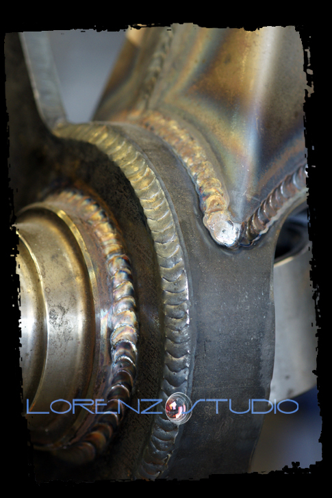

Me likes the spindle! you make that or is that off the shelf?
(Nice use of the 50mm, and that is a "watermark", I can still see the picture)
LORENZ
QUOTE (MQUnlimited @ May 11 2010, 08:46 AM) *
NIce! You could bounce off boulders with those spindles!!
They're curb and center median proof... The wife's going to be driving this booger to Albertson's on a regular basis.
I'm 75% sure that the machined 2" bearing section is a Pro-Am product, and HRT fab'd the uprights of the spindle? I'll ask.
Kevin
you can buy those spindles from proam as a weld together kit.

the spindles look like the pro-am weld together kit. your really going to notice difference in handling characteristics from a full fuel cell to a empty cell with how far forward its mounted...

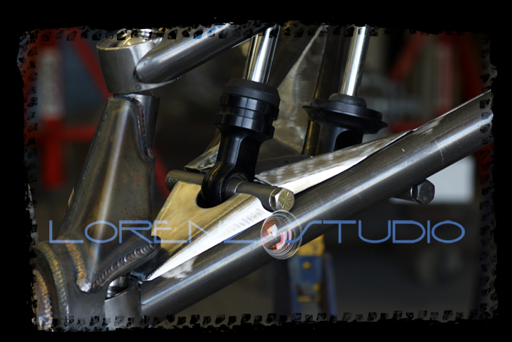

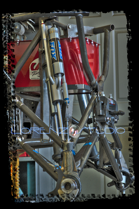

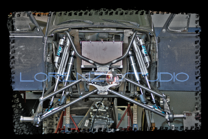

The front end is done minus welding. I'll post some pics this evening of the progress. I'm really digging the lower A-arm plating, Donny put some effort into the compound bends. Light and strong.
LORENZ

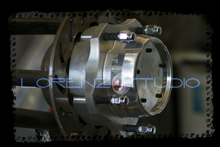

I'm digging the plate work on the bottom a-arm. The spindles are the do it yourself, Proam weld together "Econo" models. The rear hubs are Proam's Dual Sport Microstubs.

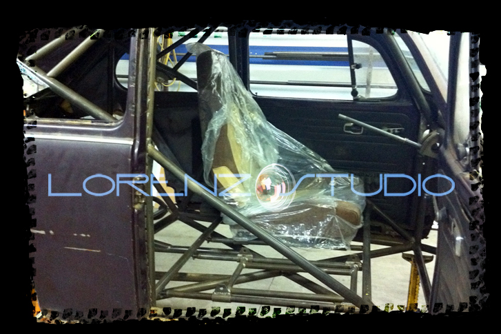

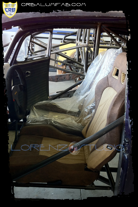

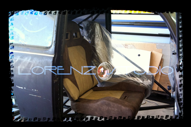

Here's a quick iPhone update.
Seat sliders are mounted, front seats are mocked up, the rear bench seat is almost mocked up. The front suspension is all tig'd up: uprights, upper/lower arms and spindles. Fuel cell was remounted slightly in order to make way for a couple more inches of leg room. There may be a trick brake pedal assembly needed in order to clear the steering linkage.
Things are coming along.

one question I've had, and have never seen, or come up with a solution for is: where do you attach the shoulder straps for the front two seats to, and still be able get in and out of the rear?? I've seen a lateral bar behind the seats like on a normal rail when it was a two seater, and there was reason to get in the back, but I'm wanting to build a 4seater.. Am I missing the obvious answer?? Looking good!!Hurry up so I can harvest your ideas. tongue.gif
You have didn't miss the obvious. There will be a bar across the back of the seats. There's no real good way around it.

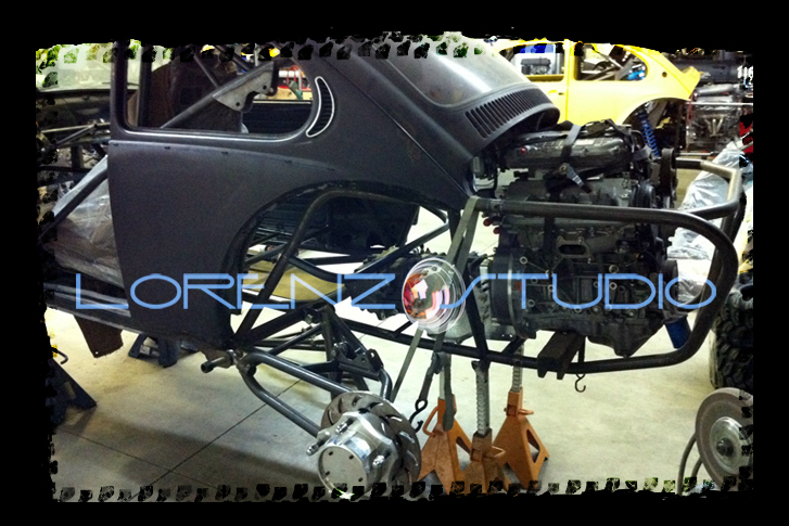

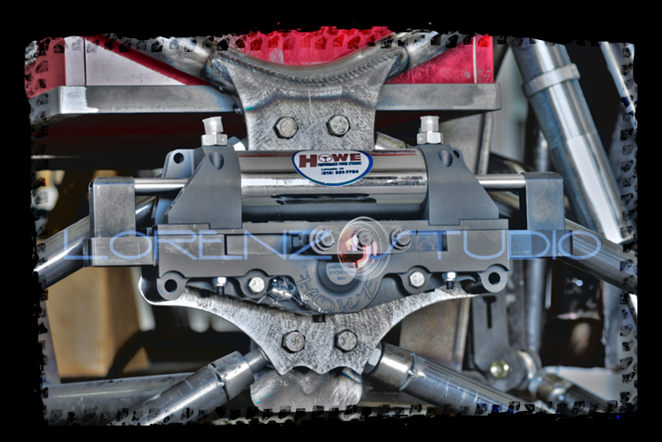

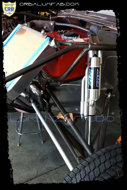

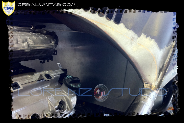

Headed over to HRT this week for some updated shots. Radiator is moved to the front to keep from turning the intake around.
Turning the intake around to face out the back created a snow ball. A new HOWE Power steering pump would be needed and relocated to the bottom left of the engine. The exhaust would have to be re routed under the oil pan to clear the pump, and a new rear cage would have to be re-fabed to clear the exhaust. Frankly, it was fiscally responsible to leave the intake were it was in the cab, and re-plumb from there.

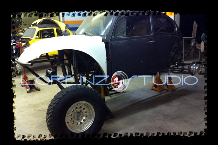

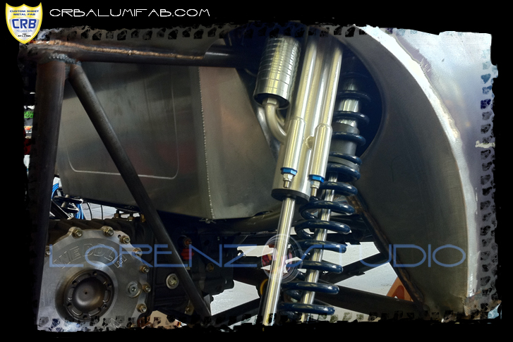

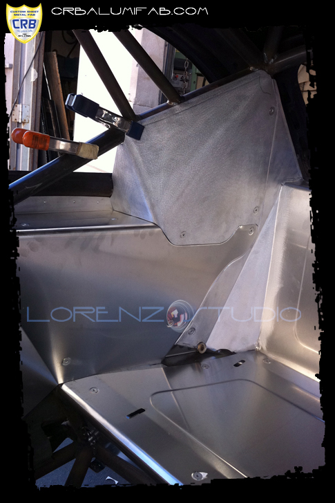

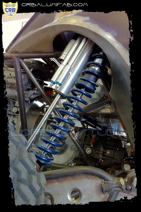

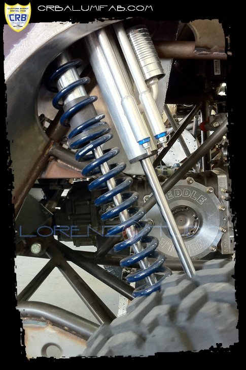

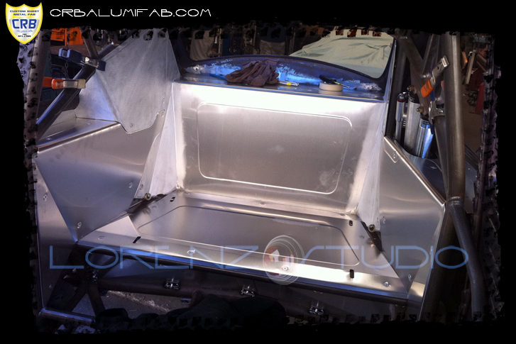

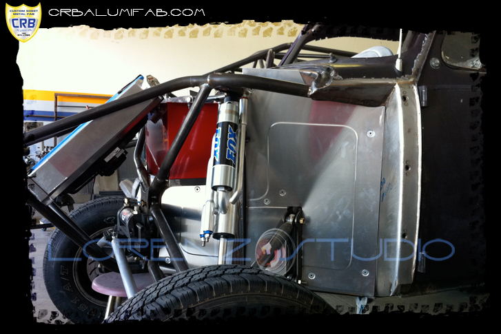

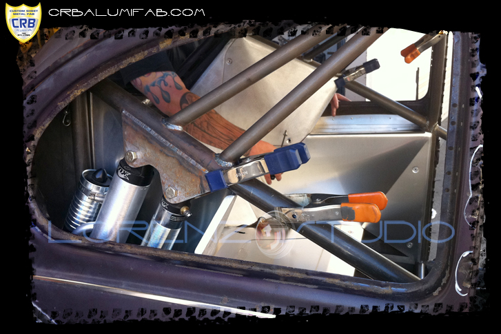

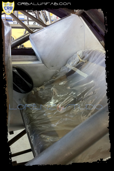

The Aluminum and Tin work is 75% complete. Thank you Curt at CRBalumiFab.com in San Diego, I'm very impressed with your attention to detail. Here's an iPhone photo update.
The Shock Coils and Bypass' were covered from the inside so the little ones won't pinch a finger off, and nobody can scald themselves on a hot bypass while they're riding in the back seat. You can see the shocks through the window though, and they get some air from the space that was left between the window and the cage. I can get a wrench back there too for tuning.

I saw this at curts the other day. It's going to be a pretty cool Baja!!!

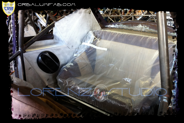

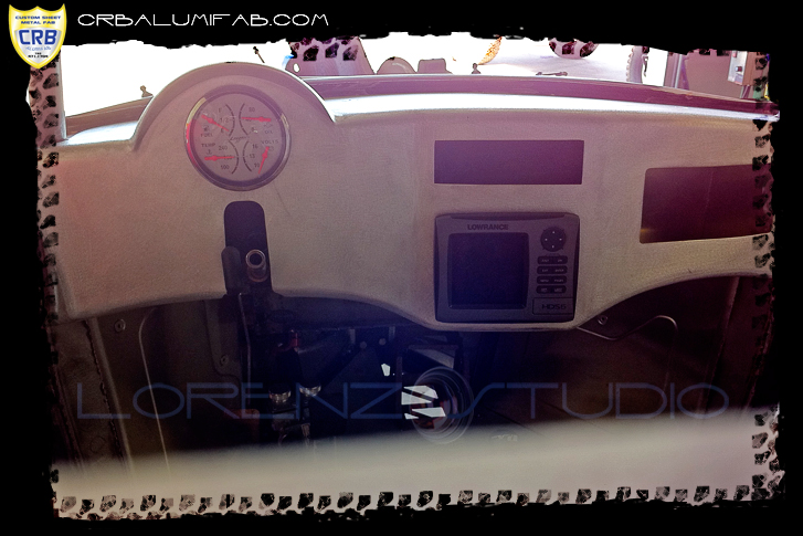

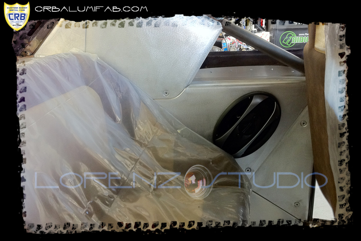

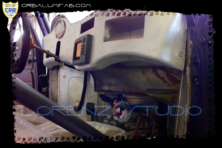

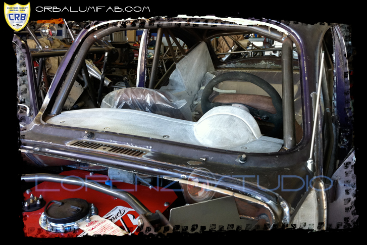

iPhone update:
Dash is complete, with a trick eyebrow for the single gauge. I'll be integrating eyebrow with the graphics scheme and racing strip. I plan on having a 3-5" racing stripe from front to rear, off center, that will catch the dash right at the gauge's eyebrow and through the center of the steering wheel. Lorwarance hds5, Sony Marine Radio, Levorsky 4 in 1 gauge, and a glove box on the passenger side. I have a Vintage Levorsky Tach to match the 4 in 1 gauge, but I'm not sure were it's going to go at this point. Should I run the tach centered over the steering wheel, and 4 in 1 gauge off to the side, or the other way around? Curt threw a nice curve into the dash so the driver has a better view of the GPS, radio, and the Gauges. Everything is angled in slightly towards the driver, for a airplane / cockpit feel.
6x9 Speakers were inlayed, just in front of the rear bench seat. I'm going to run them in a simple 2channel config off the Sony deck, nothing too fancy.
Radiator is now mounted and in. The front bars were moved around a little to accommodate it.

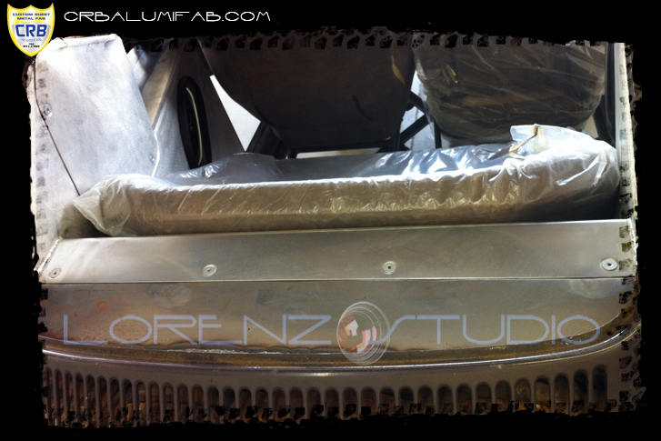

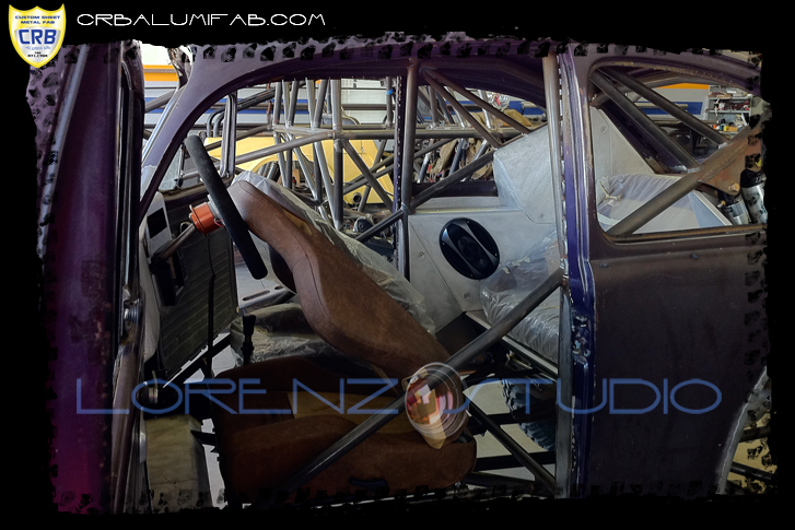

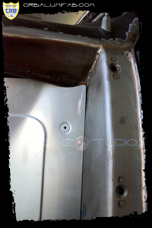

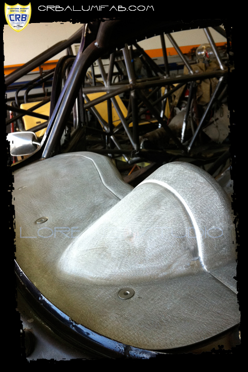

The Beetle Body has been integrated into the cage. Curt at AlumiFab did a fantastic job of keeping the Super Beetle lines, and swooping the rear quarter panel into the back half of the cage. The speakers have an enclosed box that sits between the outside of the cab and the inside of the cab. I was going to go the standard wood box enclosure route, but Curt insisted on doing a better job, and making the speaker boxes water proof.
The Doors are aligned now, and close perfectly now with a simple little "click". The front clip of the bug has a double walled aluminum firewall. 1 wall on the outside to knock down the debris and water, and another wall inside to keep the environment sealed out, and the cab looking clean without the jungle gym look of tubing around your feet.
Body dings and cancer were cut out, patched with steel, and brazed in old school style. Very little bondo will have to be used for the final prep and epoxy coat. Amazing craftsmanship, I'm super pleased.

Amazing paneling....Alumifab is doing it?
