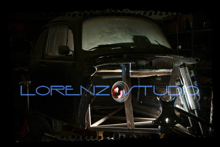

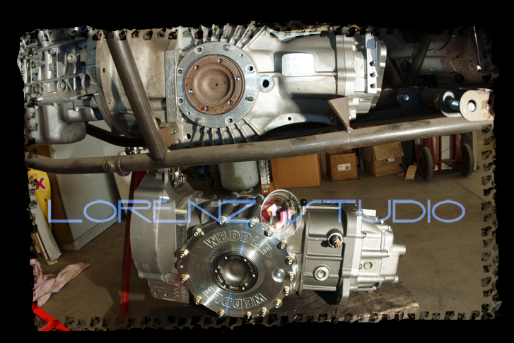

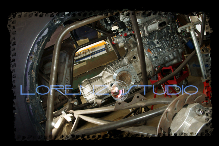

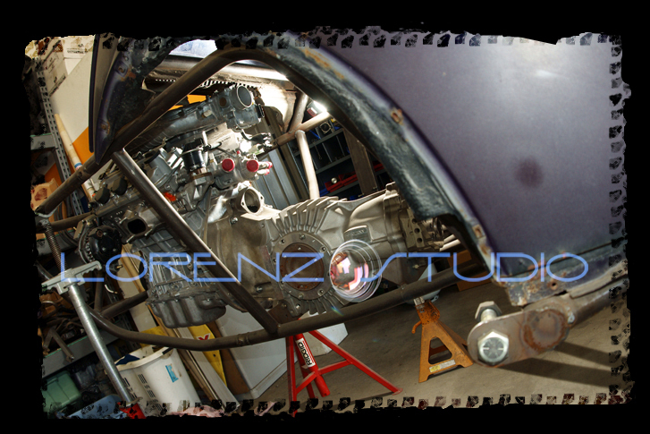

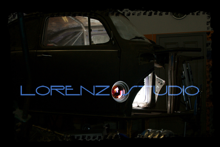

A chunk of new, hot off the press', Weddle HV-1 transaxle out back, a few teaspoons of Benchmark Performance tuned Honda j35A9 V6 Ponies, bits of Howe, a splash of Walker Evans beadlocks, and a whole bunch of elbow grease from the boys at HRT, (Hot Rod Todd for those in the know) and the Fetching Mrs Lorenz has a new grocery getter.
More specs and pics as the build progress'

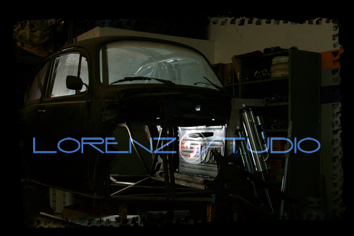

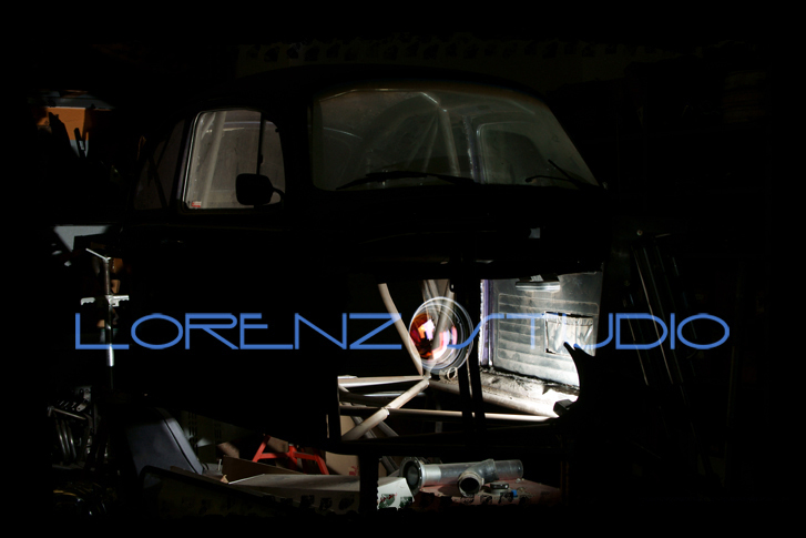

Sounds like a cool build but those pictures suck. Turn the light on, I want to see this thing.

I agree, I want to see the actual build and not looking like a billboard would be nice too.
Give props at the end or at the beginning but your water marks and advertising will ruin even good pics.

What am I looking at...

Is it an optical illusion or does that Mendi have a strange azz bellhousing?

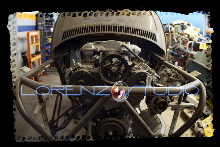

From those photos I'm thinking your gonna get really skinny cause it doesn't look like Mrs Lorenz will be getting any groceries soon. Where's the real photos ??

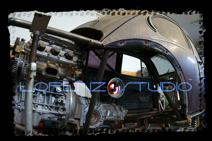

It looks like a super beetle baja. You don't see those very often.

We water mark all of our photos, they tend to get stolen otherwise. Its a pretty common practice among professional photogs in the offroad industry when posting our work on public forums. If the copyright is infringed upon, at least viewers know who shot them. It's a real build, promise, I'm teasing the first few shots to get the comments rolling. We shoot for the Lucas Oil Series, and post alot on the racing forums. That's why there done up a bit, we're used to publishing our work with a little extra umph, it's a bit of one upmanship between photogs.
The Mendiola is a 5 speed case. That's why the tail section looks a little different. Good eye, I didn't know the difference until last weekend when I dropped the Weddle off at the shop.
It is a Super Beettle, 1973 CA smog exempt. I really don't know the diffrence between models. What makes this one "Super" VWONOS, it sounds like you know your way around bugs?
The project was Todd's build that was sitting in the back of his shop for a couple of years, as MGM mentioned. I traded my Hot Rod for it, and it's now my money pit to finish.... Well, Suzys money pit... That's what I keep telling her anyways.

A super beetle has a different front end. They don't have a beam. They have MacPherson struts. I could tell by the curved windshield. I think most people prefer a non super beetle because the beam is better for off road. But you guys have full on a-arms so it looks like you are even better off then a beam car. Looking forward to the build.

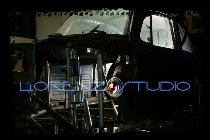

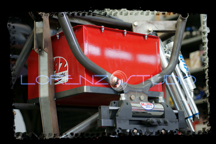

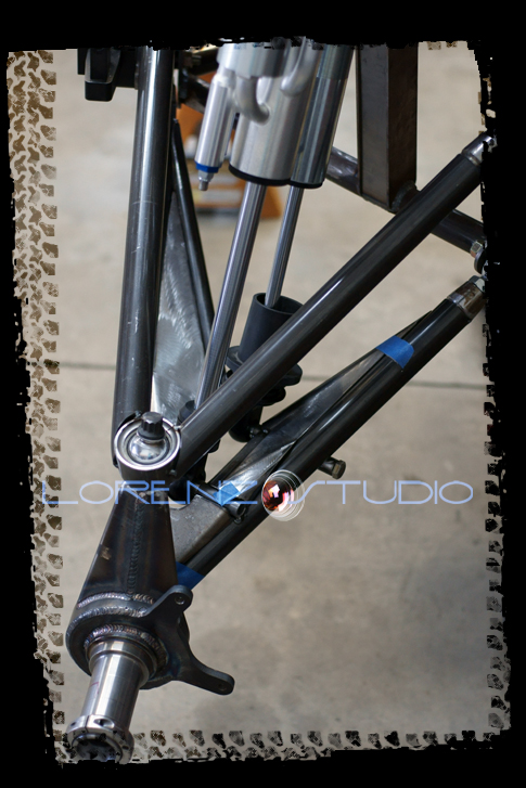

2" spindles, upper and lower horizontally mounted uni-balls.

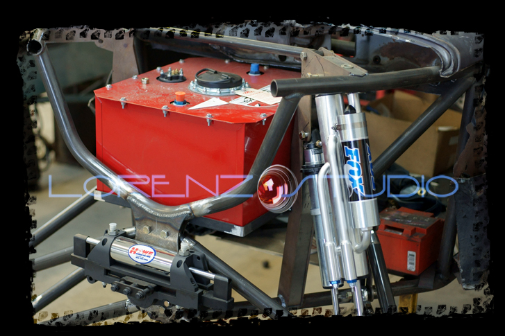

12 gallon cell between the uprights. I was hoping for a little more capacity, but we opted for a small bench seat in the back. That pushed the fuel cell to the front. It'll be a little safer up there with a firewall between the cell and the passengers... Trade offs are a bumber. I think army green jerry cans on the roof or along the rear sub frame are in order. I'm not liking the idea of fuel above me, but I think mounting them on the roof rack would look the best?
2.5 Howe Rack standard width.
The passanger side a-arms were finished Saturday. I'm digging the bracing on the lower arms. It's a little different and one off.
