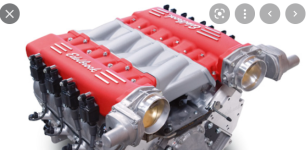

I ordered a new LS376 / 525 crate motor - that won't be shipping until March 3rd...This has given me a ton of time to read about what off the shelf upgrades can be done (if any).
The only intake that appears to provide additional horsepower AND torque are the dual plenum types...Both Holley and Edelbrock make them...all others you sacrifice torque for a smallish horsepower gain.  These also require two throttle bodies, 2 to 1 throttle cable, etc...more things to go wrong is how i see that potentially....not as reliable?
The main reasons I am looking at different intakes is 1 - the stock is ugly, and 2, because I plan to turn the intake around (mid-engine car) there are some parts I'll need to purchase to allow that to work given the oil pressure sender...whereas an aftermarket intake looks to have the clearance for the sender.  In other words, I need to spend a few hundred bucks to flip the stock intake and If I buy an aftermarket intake it looks better and at the same time it will clear the sender...money better spent on aftermarket intake potentially.
Anyone running one of the below?  Or post pics of your engine with the stock intake with whatever you did to improve the looks.

This is what I've put together from reading various articles over the last few weeks...Can't find stock LS3 before and after numbers yet for the Holley...but Edlebrock cross ram you can see it improves both HP and Torque.
THESE NUMBERS ONLY EXIST ON A ENGINE DYNO IN A CONTROLED TESTING AREA  WITH A RADIATOR TOWER
