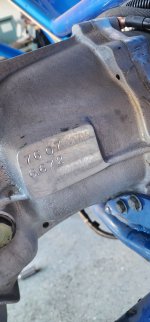

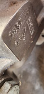

Not sure if these #s mean as far as gear ratios and if they're close.
Half the work is already done, I would swap it for the one laying around.
