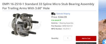

Looks like it's one of these for my setup - this is all new to me, thought at first I could just replace bearings, but after looking on Kartek's site it's the whole unit?
That’s just the unit bearing. It’s one piece. You have to replace the whole thing. I would use the Proam or Jamar bearings.
If you are running stub axles the car isn't very new, I would replace bearing and axles at this point. They will break, it is a matter of when.
