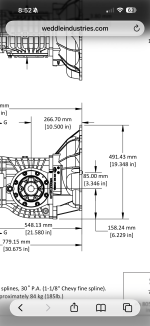

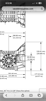

It’s up 1” and back 3/4
Following for knowledge. Also, let me know if he is selling his s4, bellhousing, clutch, shifter set up or any associated parts.
From those dimensions it doesn’t show there is any upward movement of “ drive flange center to input shaft center. They look the same. Only the belly of the bellhousing appears to go down a bit more. Can we see the whole dimensions I do see where the motor would be set back an inch.
The full pdf is on Weddle's site https://weddleindustries.com/products/S4D-TRANS/S4D-TRANS I know on the two I have done we had to raise motor mounts. If the frame allows I supposes you can drop the rear mount down as long as you can maintain correct angle.
