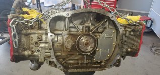

Went to borrego friday to do some riding with my friends. On the first ride coming back to camp from fonts point, I went around a tight corner in 2nd and stood on it on the way out. As usual boost comes up and I lose traction and I see the warning light on the tach come on (7K) and after a second I hear a bad noise. Oil light comes on, and the motor is desperately trying to slow down hard but I stay in it a bit to get off the road. After stopping, I notice my rear view mirror has an oil mist on it as well as most everything on the whole car, I turn the key and its locked up. Time to get out and look....
Well there is oil everywhere, I mean everywhere. I wave my buddy over and he tows me back to camp.

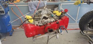

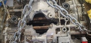

I pulled the motor today, and she has a serious problem lol. I can see the rods or what's left of them through the hole in the top of the motor.

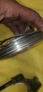

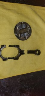

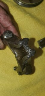

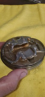

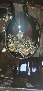

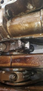

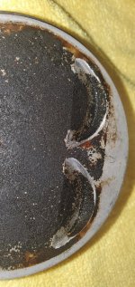

Long story short, on one cylinder the piston is now a cigar tray (Per punchdrunkmonkey). I think the rod pin said goodbye to the piston and then proceeded to smash and bang everything around the area eventually breaking in half and breaking a hole in the case. The inside of the case and the crank are all banged up and destroyed. Funny enough, the small piece of rod left on the rod journal still spun around perfectly. The oil pan has about 5-6 red solo cups worth of shrapnel. Unfortunately the piston touched the head per the marks on the piston. A valve job would fix it no problem, but I'm not going that route.
The good news is that this motor has seen 12 seasons, its a JDM motor I bought from Outfront and only swapped the head gaskets for thicker ones to lower compression for boost. I run meth injection and 91 pump, and I usually run 10-11 psi. The turbo is a BB GT28. It was tuned by Outfront and over the years I've tweaked it a bit, but the remaining pistons look great and all the rings move freely and are not caked up. I think I just found the limit of stock pistons.
I'm going to call Outfront tomorrow and see what they have for motors so I can be running again for new years.
And because everyone likes carnage....enjoy.

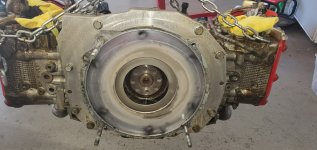

I posted a pic of the back of the old motor, hopefully @John@Outfront or someone else knowledgeable on Subarus can tell me what year and type of motor to look for. I'll buy from John is he still sells JDM motors.
I don’t have any jdm motors any more. Stop selling them close to 7-10 years ago. Too much risk. So all 2.5 are rebuilt. A new sti shortblock would be a great option but heads need to be rebuilt too.
if the other pistons still look great; wonder if one injector wasn't flowing the same as the others.....
