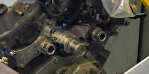

I'm using the P2R water neck and as a result i need to find / make ports for the engine water temp sensor - and the thermal temp switche(s)...the two on the outer are manufactured to give me enough room to drill and tap - one for engine temp and another for a temp switch...So i dont really have room for two seperate temp switches. That's somewhat part of why I'm obsessing about it...i don't like the idea of having both of these taped with wires on both sides and this area is exposed on the car / I want it to look clean as f...most cars all of this is hidden, but for me it's right there in your face.
IF i use the AEM i'd only need to tap one item, the engine temp sensor....yes it's more wires on the AEM as kraut explained, but it's hidden - yes i can put the temp switches in other places other than those two water neck ports, but the inline hose type look like shit, i don't want to have a bung on my radiator., etc
