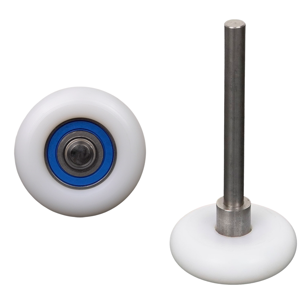

i upgraded all mine to the ball bearing skate board looking wheels.
the link is just an example
This is the hot setup.
Just did the same to mine. 20 minute job. No more squeakity-squack, it's dead silent now.

With @ChEFF help, I replaced the wheels. Go on youtube and search for wheel replacement with hammer. Before installing new wheels I cleaned up the hinges and lubed them. I also lubed the shafts before inserting them.
