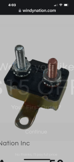

Later I remembered the circuit breaker but had already left my trailer.  Could this be the problem.
Yes that may also have a reset button on the back side. Check it.  That switch has popped in my RV several times..
if you can find that breaker, just jumper it to see if thats the issue...then buy a new one... $4.00. , keep a spare.
Mine went out once and i just put both wires on one side until the next day when I could replace the breaker.

most rvs have a 12v fuse box might want to check in there as well.    there also should be more than one of those circuit breakers 1 usually for the trailer brakes and a few others to run the slides and interior stuff
