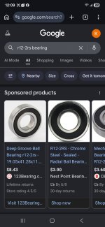

That looks like a nice heavy duty piece. I was actually looking at basic 1.625 0d and 750 ID bearings. Then just buying a piece of Dom and making my own. I no longer have a lathe so this looks like a very possible option. I think I will give them a call tomorrow.

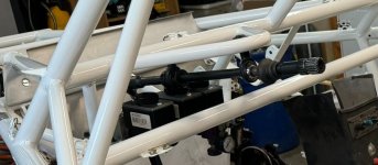

Mine is a pair of heims with collars to stop the shaft from moving its pretty adjustable and very solid.
It would be much more adjustable if the car didn't have a hanging pedal assembly. I have used the blitzkrieg setup in my ranger prerunner and really liked that as well.
