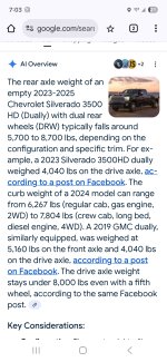

Would have never guessed that truck has 4,000 lb over the rear axle empty.
